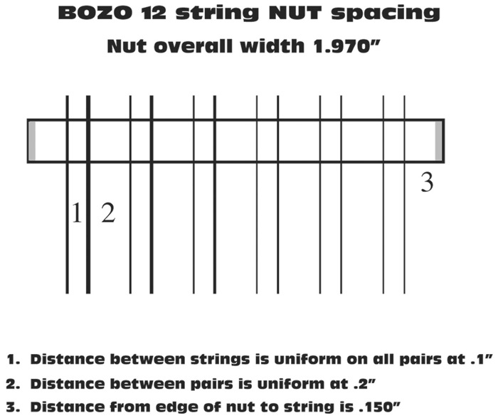

For those of you that have built 12 strings, how do you space the strings at
the nut. I am using a 1 7/8 nut.
Andy
PostPosted: Mon Feb 20, 2006 9:45 am
Posts: 389
Here is the actual spacing on a 12 string made by Bozo Paduvac that I was
lucky enough to examine several years ago. These measurements are a great
place to start to adapt to your design. Good luck!
Sylvan
http://www.wellsguitars.com
